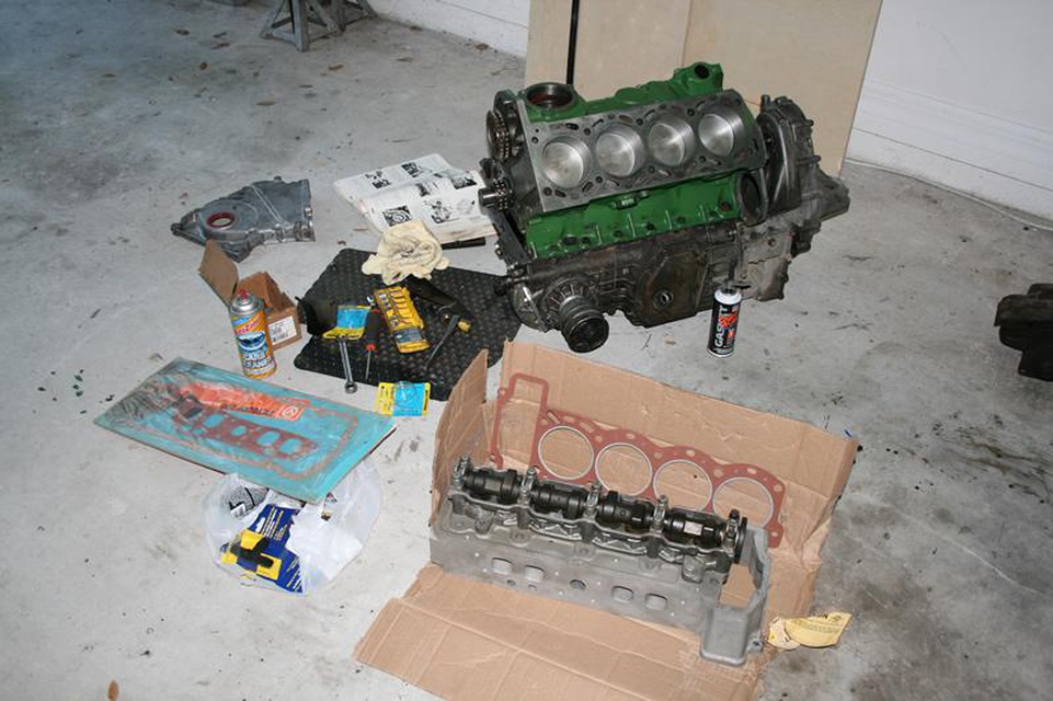

We recently built an engine block for our Saab project. Unfortunately, the machine shop deemed it unusable due to a water pump failure. We wound up cleaning and boring our spare block to fit the high-compression Pinto pistons. The entire assembly is slowly coming together.
We're going to do away with the problematic in-block water pump and go with an …
