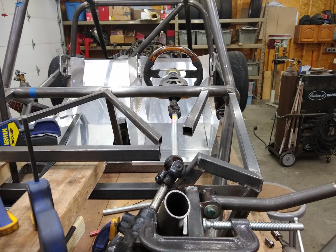

I took appart the OEM Subaru steering column and turned it into the world's shortest column.   I was going to reuse the top and make a short stub in the middle to weld them together.  But then I realized that the upper section of shaft was exactly 3/4" so I just made a extension all the way through the upper bushing.  Which Subaru uses a needle roller bearing.   I then just cut the top and bottom off the column and welded them together.  They aren't exactly the same size but close enough.

Took a quick hour and CAD templated a steering column mount.  I considered welding the column in directly but decided removeable may be the best long term for service.  I will just weld the cross tubes to the colum and then have the 3 bolts (1 through bolt, and 2 shorter tapped bolts).
It's probably way overbuilt compared to what it has to be but steering column strength and rigidity seems important..

5/3/21 11:16 a.m.
cool work as ever, just ensure that it won't spear you in an accident, as you have a very beefy mount pointing at you currently

5/3/21 11:55 a.m.
Hmm.. I'll have to put some thought into that..  I'm tempted to say that If my torso ever arrives at the steering colum in this vehicle something very very bad has happened and being speared by the steering column is the least of my concerns.  But saying that being speared by the steering column sounds horrible.
I could make the actual column break away or at least be able to move relatively easily..  I could slot the rear holes in the bracket some and make the front tube mount a U rather then a full tube.  That way the steering wheel would move forward in a large impact.  I can't really make the columng mount bracket break away..  Though I could cut part of it away to maintain rigidity but make it so it would collapse if really really impacted..   The steering shaft it self will have the ability to fold out of the way (Multiple u-joints) so it's not going to force the steering shaft backward into me while I'm still in the harness.
The stock MG midget column (A shining beacon of occupant safety if there ever was one) has metal bushings that allow for about 1" of column forward movement (This is in addition to the actually collapsible shaft and lower column).  So in an impact the shaft would collapse and the actual steering wheel would move forward about 1" if an occupant slammed into it.   In the stock Subaru the steering column mount was solid at the wheel because it is the base for the airbag to work.  In an impact the column would collapse but the steering wheel itself would stay rigid.
I think the actual wheel end of the colum staying basically rigid is a pretty common layout?  Most race cars I've seen use a 3/4" non-collapsible steel shaft with 2 or more U-joints to prevent spearing.  That shaft is rigidly supported by a 3/4" rod end anchored usually to a tube welded to the roll cage, or they use a stock upper column with stock mounting.  Unless I am missing something the actual steering wheel and it's mounting are designed to stay in place, with all the design work spent to prevent them from being pushed into the driver.
These are good conversations.  Please keep having them.  I'm trying to think of Everything..  But everything is big.  If you see something that's a concern I love when people point it out and we can discuss it.  I'm fine with re-doing work if it makes it better/faster/safer.

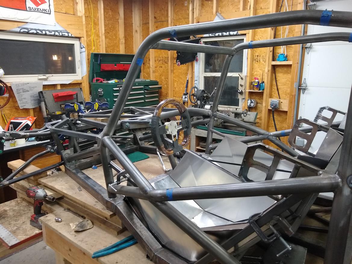

Karplus2 came over again and yesterday evening we got the collumn mounted, steering arms cut, and tack welded in.  I more Ridgidly clamped the rack in place and made with the turning of the wheels from a remote distance.
I also learned I did a bad at math. My current effective steering ratio is 16:1 which per this chart I found (https://sites.google.com/site/mitostile/vehicle-dynamics/simulation/databases/steering-ratio)  is pretty mediocre.  The steering arm on the car is 4.75" long.   I compared 90* and 180* turns to the MG and was getting about 66% of the steering angle the MG achieved for the same turns.  The MG has ~11:1 and is pretty good. I would be happy with that ratio in the 360.
The Subaru rack I have moves 1.75" per turn.  For my desired steering range of ~400* total for all possible autox turns I will have to calculate the new steering arm length.  The minimum I can run without changing big things is about 3.25".  Just based on the fact that the current ratio is 16:1 and 3.25/4.75 = .68 I should get right around 11:1 steering ratio.  I will validate that that produces a wheel steer angle sufficient to turn the car around an Autox min radius turn at ~200* steering travel.  I know from onboards I rarely ever exceed 150* and the Max I've used is ~200.  Road course unless I'm sideways it's all <90* steering angle.  So I think I will be ok if I can get to ~11:1 with moving the steering arms in more.  We will see.  I own a welder.  If it needs quicker steering after use I can either find a rack that moves father per turn or redo the steering arms again.
I will put together a spreadsheet that takes rack travel per turn, desired steering wheel rotation, vehicle wheelbase, and steering arm length and spits out turn radius and steering ratio.  Once that's done I'll post some results and share it for everyone.  I didn't want to do more math but after failing it's time to do some math.
The good thing is I can compare the MG and the 3 additional racks I have accumulated to see if any of them would be worth trying.   I have anothe MG rack, a geo metro, and a 1995 Miata.  Initial inspection shows they all are around 1-3/4 to maybe 2" per rotation.  I would need more like 2.5" to make a swap have enough benefit to have to carry a rack In the budget.
