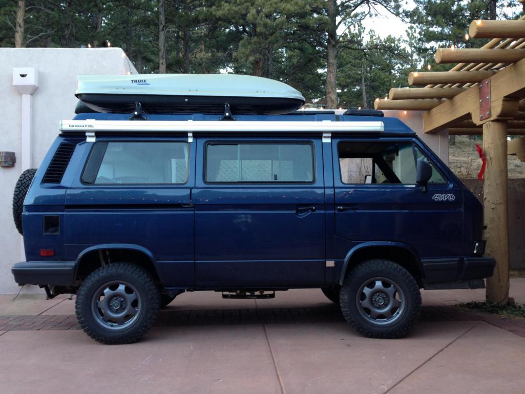

914Driver wrote:
That is cool

Thanks for the feedback, guys. I'm not sure what to make of the van references, although finding an uber-rare supercharged, manual transmission, awd Previa is a unicorn of interest - but not relative to this potential project.
