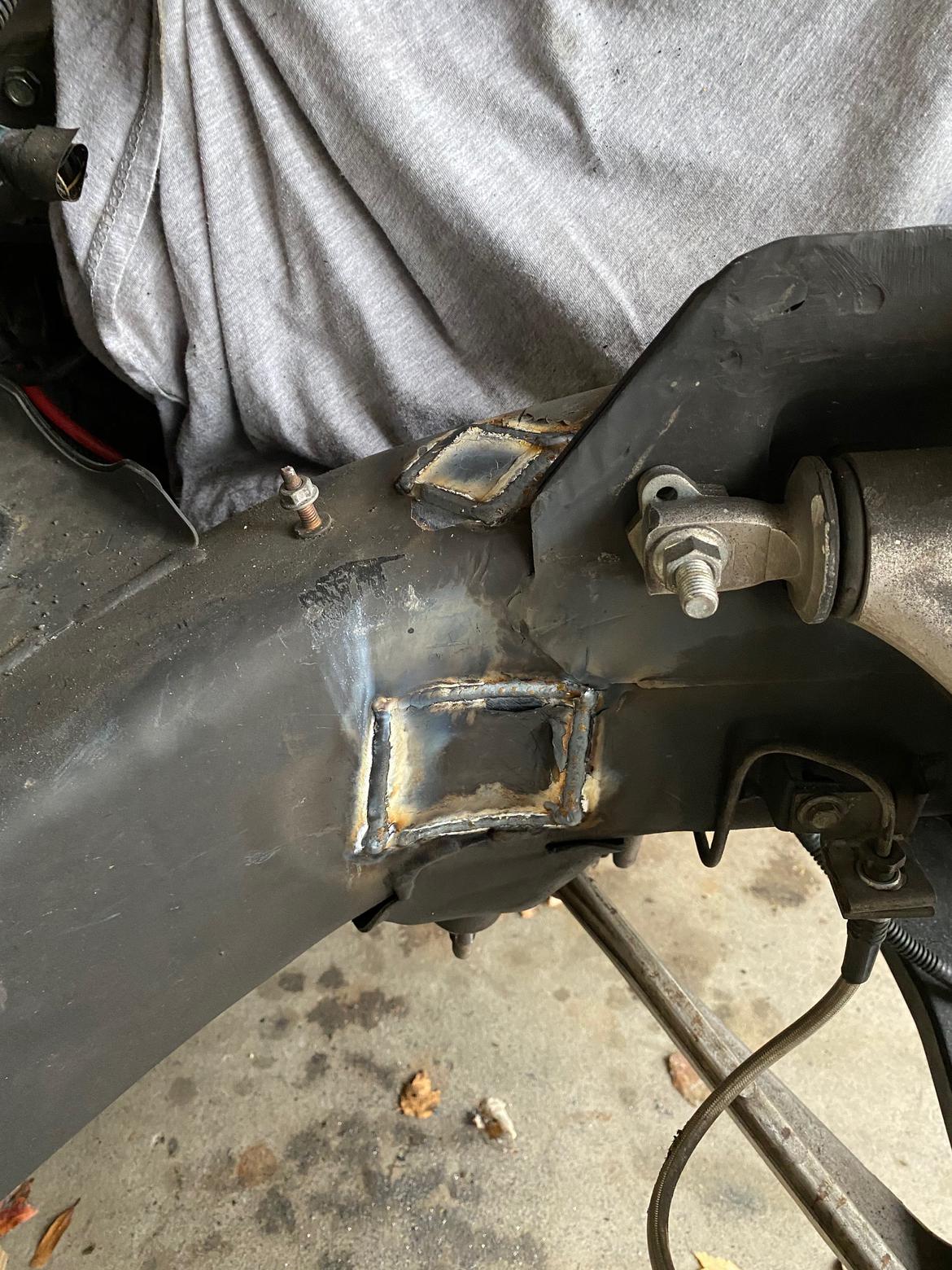

fully committed at this point. the frame has been delicately cut to accommodate. there is a plan to truncate the frame to cradle bolts. the entire plumbing arrangement has been ordered and a entry point for the hoses has been made on the passenger side frame rail near the water pump.
additionally, the entire exhaust run, the over the axle portion had to be adjusted to make room above for the radiator, is now 3" dia.
plan for today is boxing in the driver frame rail. making mounting brackets and truncating the two impeeding frame to cradle bolts on the passenger frame rail.

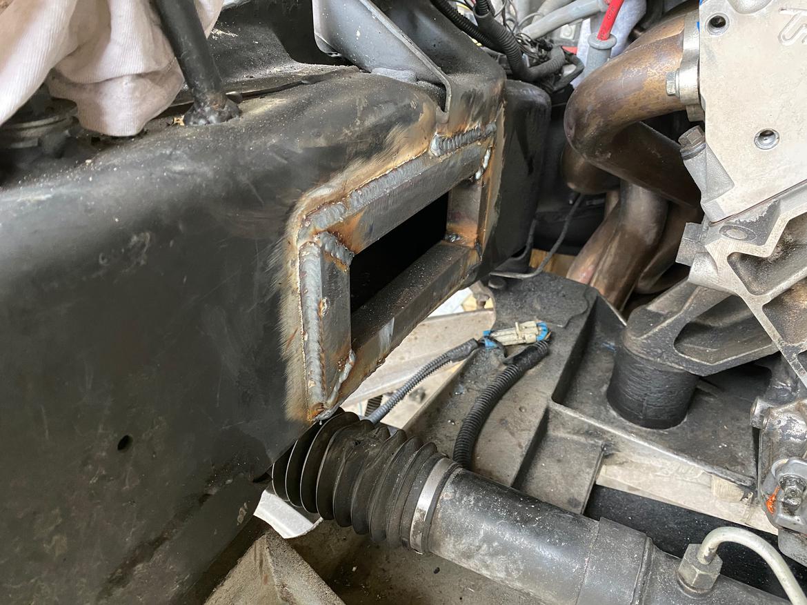

More progress pics of the radiator mounting effort...
this is the reinforced entry point for the hoses at the motor.
for the hose to pass through the frame the bolts securing the cradles to the frame had to be truncated as they pass through the frame.
its all back together.
