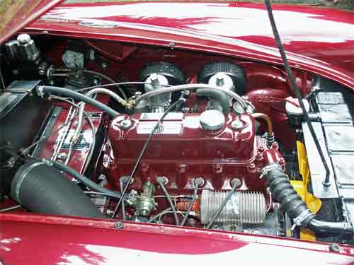

An MGB engine would be the easiest swap if you want to keep it vintage. I think you could use the original transmission. The horsepower would also be vintage.

I might have this as one of my waiting in the wings combination, a 1960 MGA Coupe with a 3 bearing MGB 1800. In my case I would call Moss Motors and arrange to have the Miata gear box that fits this motor and one of every thing required to get my car back on the road.
Ok, it might take more than one, of everything.
In my case, anything that was rubber is completely perished. But, next to no rust.

5 bearing Mg engine. Crossflow head. Dual webers. Easy and relatively cheap.

1 - MGB. I use a slightly tuned 3 main MGB engine in my 62 coupe
